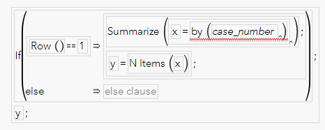

I see how this would work for a script to create a column, but I've created a datatable that I update from a database and I'd like to have a column in that table with a formula to calculate the number of unique categories. Is there a way to do that directly in a column formula instead of though a script?
I found a hack using using Def() and Col Sum but it only works because i'm looking at a sorted field that's a unique id with numbrers. It doesn't work for actual text variables. Is there a better solution for that?
Here is the hacked formula:
Col Sum( Dif( :customer_id ) > 0 )
Thank you,
Aron
txnelson
Re: Formula for Number of Unique Categories in Column
The stated formula from my last response should do what you want.
If( Row() == 1,
	Summarize( x = by( :Customer_ID) );
	y = N Items( x );
y;
Just cut and paste this into the formula editor
Jim

aronwilson
Level II
That worked great! I was thrown off by the red underline, I thought that meant it wasn't going to work.
I'm not actually sure I've ever tried pasting a formula directly in the column before, I thought I had to rebuild it using the explicit formula column functions... this is a huge improvement. Thank you so much for the quick reply!
