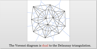

I tackled this task because I have been trying to learn more about generating 3D terrains using opengl which has mesh methods. However, I do not know enough about them yet. I decided to tackle craeteing the dual Voronoi graph because spatial geometry is an interest of mine. As stated in my first reply, JMP Triangularization (can be found in the Help > Scripting Index under objects) creates the Delaunay traingularization and also provides messages to get, triangles, points and edges.
I expanded my script to compute the Voronoi dual graph. I have not tested performance for dense points; many of the websites with alternate algorithms and approximations deal with performance. Using the pseudo code reported at the link Craig Hales provided, I created a script. I have only tested it on the single example data table. By the way that data  table was generated by copyiong the picture from the link, using it as a background in an XY graph and using mousetrap to capture the coordinates as i clicked on the vertices. You'll note the left most point is a little more left than the original. [yes JMP provides numerous tools to tackle a task.]  The new script seems to do the job.  It is not application ready, uses  a square frame, not a circular wafer, and it standardizes the points (so centered between +/-3 in X and Y).
The script  includes a file LCombine.jsl (one of the scripts from "JSL Companion Applications of the JMP Scripting Language, 2nd Ed."). It is attached. You will need to change the path in the attached script to the directory where you saved it. I attached the picture generated by the script. It was tested in JMP 12, 13 and 14.

I am not an expert in this area, however, I recalled reading that JMP Triangularization is an implementation of the Delaunay triangularization which is the "dual" of Voroni. I do not have the algorithms for computing the "dual" plot.
Attached is a sample data set called voroni.jmp that I created to emulate a set of points that are found in several Voroni training documents ( see http://cgl.uni-jena.de/pub/Workshops/WebHome/cgl12new.pdf ).  The  attached PNG file shows the "dual" relationship of Voroni plots and Delaunay tesselation (triangularization).  This attached jmp file has several data table scripts attached. I tested them in JMP 12,13 and 14.
Run each of the table scripts that create graphs. Since you are intrerested in density per unit area, look at the graph Density of Y By X then use the inverted red triangle menu to select a Mesh Plot for a 3D view of density. These views might meet your need or be more informative regarding density.
If the density plots will not serve your purpose and you are still interested in Voroni plots, you can get them from the deldir R package:  see https://flowingdata.com/2016/04/12/voronoi-diagram-and-delaunay-triangulation-in-r/   Since JMP does have nearest neighbor and distance algorithms, maybe someone will provide this blog with the necessary steps ( or JSL), to create Voroni diagrams.
Your question motivated me to test the JMP Triangularization method and verify it produces the "classic" results ... after the X and Y coordinates were standardized. [ thanks! ]  The attached JSL has steps for drawing the triangles.
