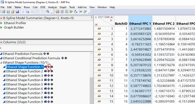

1) First, extract the formula by first saving the summaries:
2) From the summary table, you can find all of the Shape Function formulas within the hidden columns of the table:

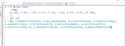

3) Clicking on the + symbol will open the Formula editor for that column, showing the formula.  Double-clicking on it will display it in JSL, which can then be selected and copied:

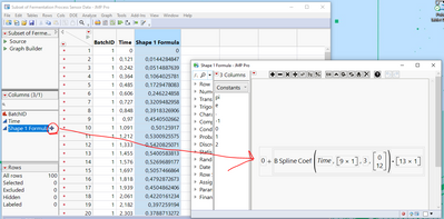

4) Next, create a new column in your original table, or in a new table with the independent variable in another column (in my case, Time):

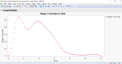

5) You can now explore the function in more detail, for example, by plotting it in Graph Builder if you wanted:
