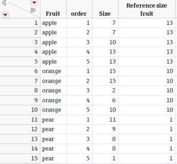

Formula column where all row values are a certain column value matching another column
I have a table like this
and want to create a new formula column (reference size fruit) where the row value is the value to the Column "Size", but with the condition that the order is 5 and the value updates for each fruit type.
E.g., the result should look like this:
I can do it using a nasty workaround (marking 5 in column "order", select matching values, do a subset using selected rows and update the original table with this) or I could write a JSL script, but I would prefer a Formula column solution for compactness.

As no example data table (images won't really work as data tables), I wrote smaller table to use as an example.
The formula might look a bit complicated, but works with the example data
:S[Col Max(Col Min(Row(), :F, :o == 5), :F)]
but it should be fairly easy to understand if you split it into three different formulas (I have attached data table with these). Idea is that first you get the rows numbers per fruit based on if Order is 5 or not using Col Min(). Then you use Col Max() to get maximum value of that column. Finally use the row number to get value from :Size column.

Re: Formula column where all row values are a certain column value matching another column
It's magic! Thank you, that was exactly what I was looking for.
Sorry for forgetting to attach my demo table.
