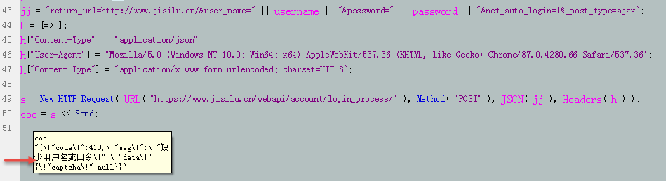

It not work:
s = New HTTP Request( URL( "https://www.jisilu.cn/login" ), Method( "get" ) ); data = s << Send; username = "lala"; password = "jmp"; jj = "return_url=http://www.jisilu.cn/&user_name=" || username || "&password=" || password || "&net_auto_login=1&_post_type=ajax"; h = [=> ]; h["Content-Type"] = "application/json"; h["User-Agent"] = "Mozilla/5.0 (Windows NT 10.0; Win64; x64) AppleWebKit/537.36 (KHTML, like Gecko) Chrome/87.0.4280.66 Safari/537.36"; h["Content-Type"] = "application/x-www-form-urlencoded; charset=UTF-8"; s = New HTTP Request( URL( "https://www.jisilu.cn/webapi/account/login_process/" ), Method( "POST" ), JSON( jj ), Headers( h ) ); data1 = s << Send;
Craige_Hales
Re: What url you need to log in to and how you can get cookies and download data through JSL login.
What did it do? Anything in the log window?
Show(data);
Show(s<<getResponseHeaders);
Show(s<<getWarningHeaders);
Show(s<<Get Status Message);
Show(s<<Get Last URL);
If you have Python code that works, why not use it?
Use the Python code to make a .csv file and import that into JMP.
You can call it from JMP, either with the Python interface or with RunProgram.
Same thing with a VB program to make a .csv file and import it.
Craige
lala
Level IX
  • show:   A user name or password is missing
Craige_Hales
This is beyond the scope of this forum. Perhaps the site provides an API for what you want to do.
I think the site uses javascript to help verify you are properly logged in.  JMP does not run the javascript.
The captcha may be part of the problem, and may require human interaction.
If the user name or password contain special characters then it will need some sort of encoding.
The 413 error code might mean something else is wrong.
Craige
