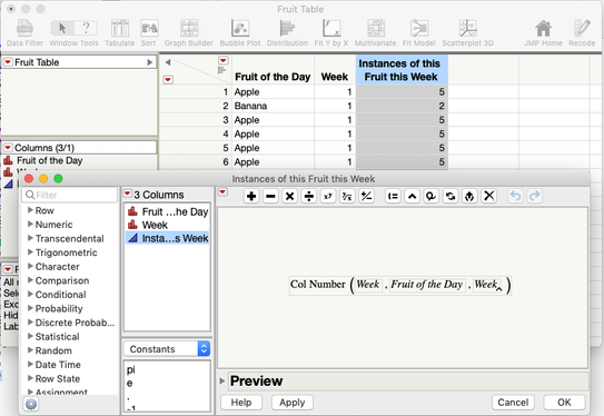

Jeff_Perkinson
Re: Formula Column for "N" Instances of Column 1 per value of Column 2
Here's a formula that will work. The Col Number() function counts the number of non-missing rows.
Col Number( :Week, :Fruit of the Day, :Week )
-Jeff

Yes, this works perfectly. I have created a script for the new column using the formula:
Col Number()
