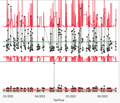

I am having an issue creating a control chart when trying to script it with JSL on JMP17. I have a column that contains a long date and time in the format "02/24/2023 8:22:00 PM". I would like to use the formula Abbrev Date () to change the format of the label on the X-axis to only the date "02/24/2023" to reduce the clutter in the control chart. If this isn't the best way to do it, please point me in the right direction.

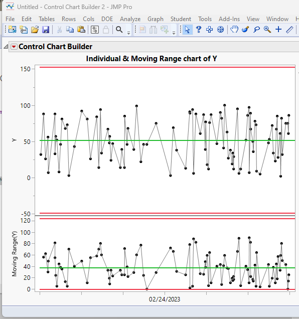

Here is another approach that does not use a subgroup
theLabel = format(:testtime[1],"m/d/y");
ccb = Control Chart Builder(
	Variables( Y( :Y ) ),
	Show Control Panel( 0 )
report(ccb)["Control Chart Builder",TextEditBox(4)] << set text( theLabel );
Jim
