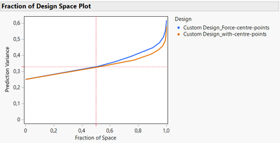

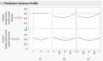

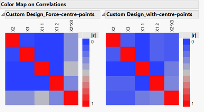

You can then compare this situation ("..._Force-centre-points" design) with a default Custom Design with same number of runs and 3 centre pojnts ("..._with-centre-points" design) using the Compare Designs platform.
  • You can expect a slight decrease of power for main effects :
  • You may also expect a slight increase of variance prediction over your experimental space due to this "forced" runs imbalance :
  • Due to the different matrices generated, you will probably encounter different aliasing structure :
So if you want to assign one centre point to each block for practical reasons, you will have to do it manually, as this situation is not optimal regarding the repartition of factors levels. It's a compromise between design performance & optimality, and the practical use of centre points you want to do.
