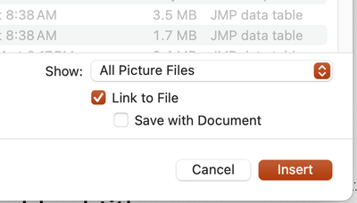

In powerpoint there is an option to insert an image and link to the file. It looks like this on a Mac, PC has the same thing from the insert down arrow button.

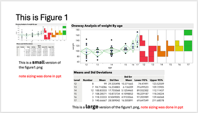

 I used the script below to make a png file from my JMP report, then used the insert and link option in powerpoint. The same png is inserted two times, and scaled differently. The slide looks like this:

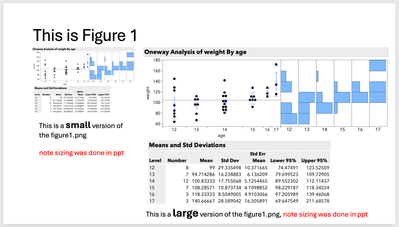

Close the powerpoint slide, then run the rest of the script and open the powerpoint slide again.
Upon re-opening the slide the figure now looks like this:
The really fantastic part of this is that you don't have to fight with sizing your graphs in JMP, all of that is done in powerpoint. The positioning and alignment of the images is done in powerpoint too.  PPT essentially makes a box with a specified size and location and fits what ever the image file is, into that box. If your graphs get bigger or smaller, the get resized to the box automatically.
Granted, it's a little bit of a pain to set up the slides the first time, but after that it's super easy to do the updates.
