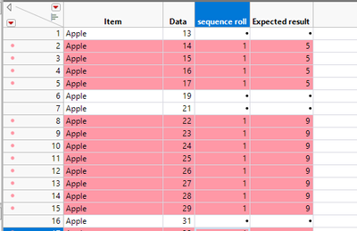

Hi,
I was able to identify consecutive values on a column "Data" (Refer to " sequence roll" column). However i need to generate a column (refer to Expected Result column) to sum up the number of consecutive values.
Any help or advice will be appreciate. Thank you

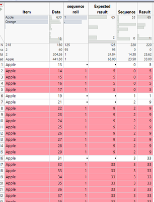

I would create two columns, Sequence with formula such as
As Constant(seq = 0);
If(Dif(:Data) != 1,
	seq++
seq;
and then use that for calculations using Col Number
Col Number(:Sequence, :Sequence)
If you want to make first row missing, you can do that by adding if statement to result
If(Row() == Col Min(Row(), :Sequence),

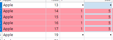

Is there a specific reason of dropping out the value from first matching row while still adding it to the calculation?
Here you have 5 consecutive values but first row is set as missing.

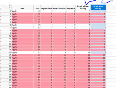

Re: How do i sum up number of consecutive values within the same column?
It works!
Thank you :)

Hi,
No specific reason. Just that my formula to check sequence roll is depending on the previous row above.
