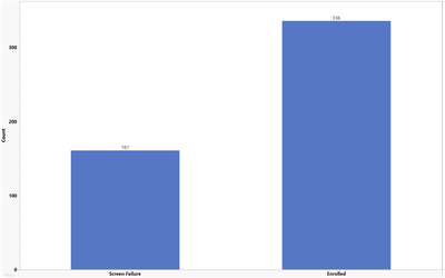

Font size for the 'Label by Value' inside the graph builder
How can I permanently change the Font size for the 'Label by Value' inside the graph builder?

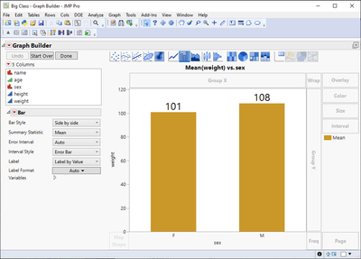

jthi
Re: Font size for the 'Label by Value' inside the graph builder
For me (I'm using JMP18.2 with Windows 10) it seems to work fine for bar charts.
With defaults for me
After setting Graph Label font size to 20 and rerunning the script to create same graph

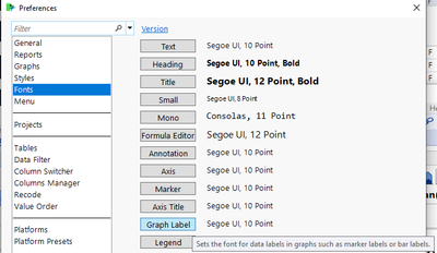

jthi
Changing the Graph Label font preference
Though, this will most likely change it for other than just graph builder

sanchezpeinado
Level III
Thank you. I have done that many times, and the font inside the graph stayed the same.
jthi
-Jarmo
