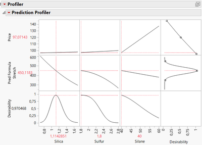

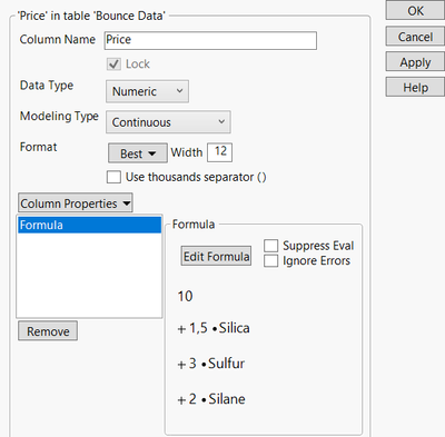

As an example on dataset "Bounce Data" with the response "Stretch", I added a column "Price" with a defined equation:
Once a model build on response "Stretch" (Y1), I save the Stretch Prediction formula and Launch the Prediction Profiler Platform with the two formula (predicted Stretch formula and the one calculated for Price in the datatable) to optimize both responses :
This would be the first approach you mention. As you already know the formula for Y2, it doesn't make sense to try to model it.

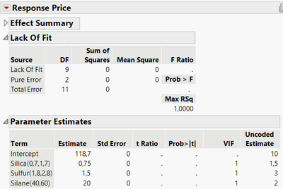

It's not a problem of multicollinearity, as each coefficient could be determined independantly and precisely (without errors) with the design used (VIF = 1 and Std error = 0):

I agree with Victor, you won't have a multicollinearity problem.  Multicollinearity is with correlated x's not Y's.  You may have x's that conflict and need to be set differently to achieve both Y1 and Y2 and therein lies the potential issue.
