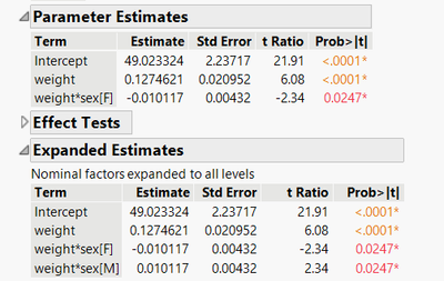

on here appreciating this older tip about using Fit Model by not centering polynomials and just thought I'd note that in Fit Model the Expanded Estimates are a little less cryptic, especially if there were more groups.  I'll be using those where I want to get the slopes out of there with JSL but can see that the plot from Fit Y by X is nicer.
