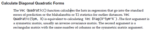

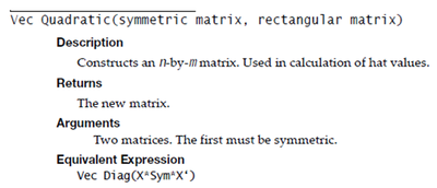

Having discussed the JSL 'Vec Quadratic()' function with a computer scientist, we both agreed we didn't understand the exact workings of it. I've also checked the Scripting Index and Documentation Library:
The issue came up with the attached example of prediction and confidence interval calculation, where this function is used. Specifically, what none of use can read is the part after the covariance matrix, and why it involves a concatenation ('[1] || :X') (see also screenshot below).
If someone could explain or point me into a direction of further documentation, I'd appreciate that very much.
