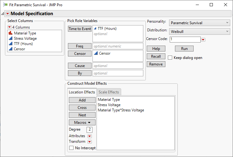

You might use Fit Parametric Survival instead.

Just to build a bit on what Mark outlined, if you are looking to use the same BoxCox transformation you could transform the Stress Voltage variable right in the effects panel after you add it. The log transformation should be appropriate since you were interested in a BoxCox relationship with a lambda of 0, which according to the documentation will be equivalent.
