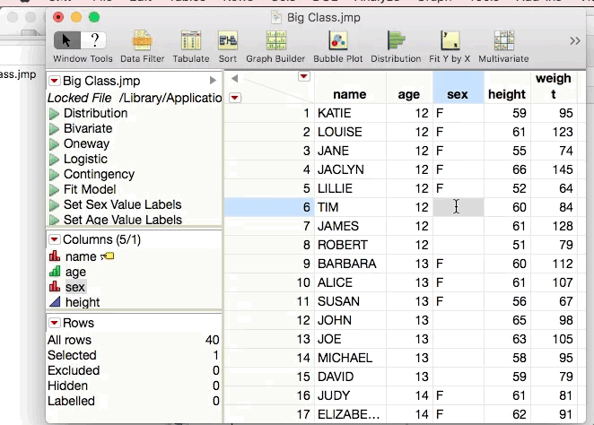

Filling empty cells in a specific “character” column
Hello,
I need help with filling empty cells in a specific “character” column.
I was able to find a script that does it to all numeric cells of the entire table, but I need it to edit a specific text column.
I have something like the table below and I want to fill the empty cells in the "United" column with an expression like "PASS".

Jeff_Perkinson
Re: Filling empty cells in a specific “character” column
The fastest way to do this is to type the word "PASS" into one of the cells. Then select it and use Edit->Copy to copy it to your clipboard.
Then right-click on one of the empty cells and choose Select All Matching Cells and then choose Edit->Paste to paste PASS into all the cells.
If you want to do this programmatically let us know and I'm sure we can point you in that direction.
-Jeff
