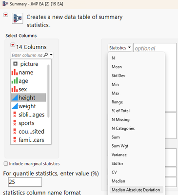

If you want to calculate MAD for a column, you can use the Tables/summary platform:
Often, users want to calculate MAD for individual groups.
But unfortunately, there is no Col MAD (values, grouping) function in JSL - not yet.
