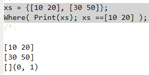

how can I use the new Where function with lists of lists or matrices?
xs = {10, 20, 30, 50};
Where( Print(xs); xs ==10 );
xs = {[10 20], [30 50]};
Where( Print(xs); xs ==[10 20] );

"refers to each individual element"
... actually like in the second example.
Which makes me wonder about the second result - xs is [10 20], but Where doesn't find the match.

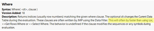

Also doing it this way seems to be slower than just using Loc() but my test might be flawed

Thanks for the insights and the trick via Mask  - much faster than
Where( xs[0,1] ==10 & xs[0,2] ==20 );
... but no chance to beat Loc.
kind of surprising ...
