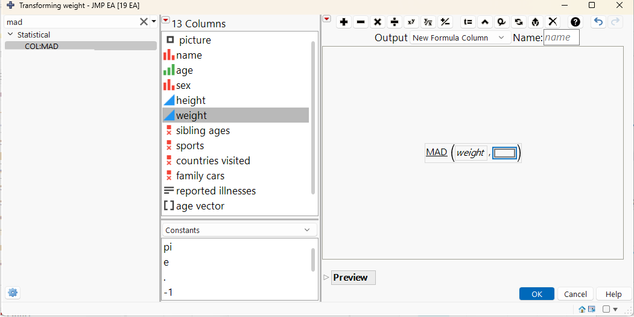

use JSL to create a Custom Function
Add Custom Functions(
	New Custom Function(
		"COL",
		"MAD",
		Function( {value, byGroup},
			Col Median( Abs( value - Col Median( value, byGroup ) ), byGroup )
		<<Formula Category( "Statistical" )
and share the script as an AddIn ...
Then every user can use the new col aggregation via:
Unfortunately: This approach doesn't work : (
Does anybody find the error?

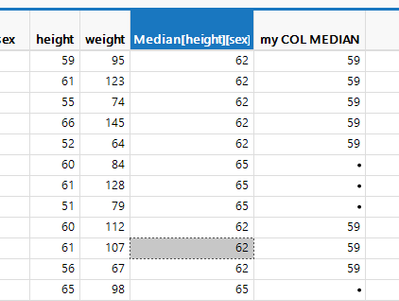

For debugging, you can use:
Names Default To Here( 1 );
		"COL",
		"Median",
New Column( "my COL MEDIAN", Formula( COL:Median( :height, :sex ) ) );
on my system (JMP 18.2.0 & JMP 19 EA 9) , the result looks like this:
does it take the value of the first row?
- and use it for "F" , not having any value for "M"?
