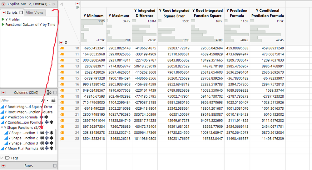

Thanks for tagging me, @jthi! If I'm understanding correctly, Save Summaries is what you're looking for, but JMP hides the columns with the actual formulas in them by default. Here's a quick example of how to extract and use these formulas, using the attached data table.

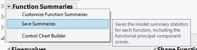

  2. Red Triangle by Function Summaries > Save Summaries
    1. The Shape functions are in the columns list on the left, but are hidden, so they don't show up in the data table.

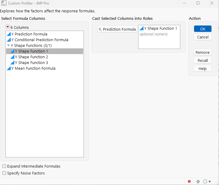

    2. One way to use them is with the custom profiler. Graph > Custom Profiler > Choose one or more of the shape functions.

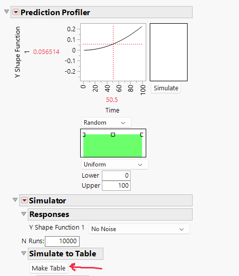

    3. You can then add a profiler (Red Triangle > Prediction Profiler) then set up the simulator (Prediction Profiler Red Triangle > Simulator) to make a table with output from the formula.

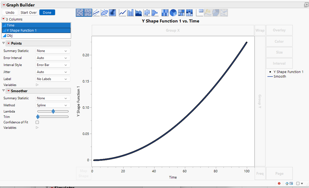

    4. The resulting table has values from the formula which can be used in the Graph Builder, etc.

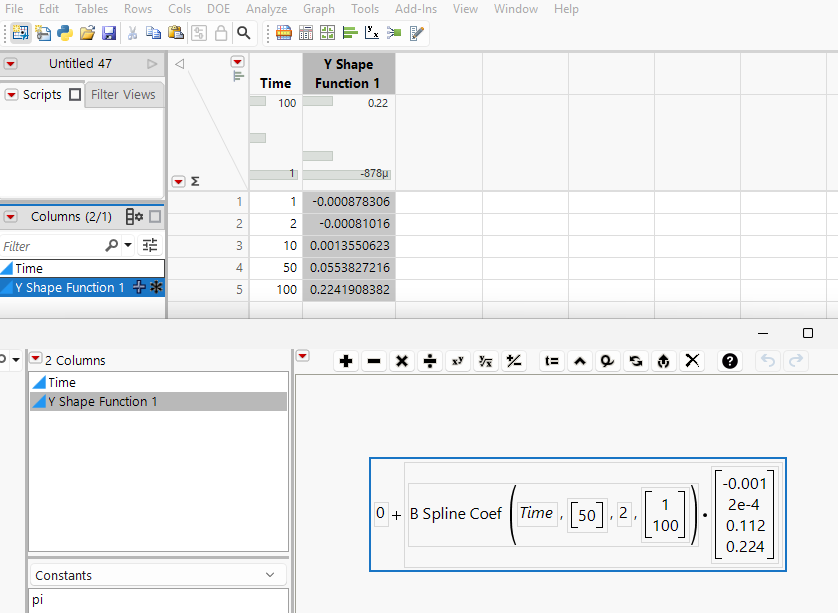

    5. You can also use things like the Formula Depot and Copy/Paste to move the formula itself to different tables.

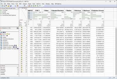

Thank you for your kind reply... i've actually clicked on that button several times but when i do, I get a table like this... I was expecting a column that would be my wavenumbers (im working with spectral data) vs absorbance for each point (around 1762 rows) so that i could graph back the mean and shape functions.  Does this have anything to do with me analyzing the data in wide format? (wavenumbers are columns and rows are individual samples) for analysis I've selected the row as functions...
Thank you :)

Thank you ... Unfortunately, I've tried all three options in the Functional Data Explorer (stacked, rows as functions, and columns as functions ) and none of them worked. When I click save summaries, it shows a table where each row is the sample ID rather than the wavenumbers used to construct my mean and shape functions... It's strange that you couldn't replicate my findings using JMP 18.2... may be there's a workaround that I should do for JMP's student version? Or perhaps I'm missing something?

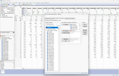

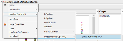

To my knowledge JMP Student is same version of JMP as JMP Pro. How did you fill in the platform launcher?
This is JMP's example table "Functional Data/NMR DoE.jmp" and I removed "FDE X" column properties.
Then if I just pick some model
And then Save Summaries
I will end up with
(for this example I did use JMP Pro 18.2.1)
If you repeat this example, will you end up with similar results as I did?
-Jarmo
  1. Run the FDE script in the attached data table (just some simple curves).
