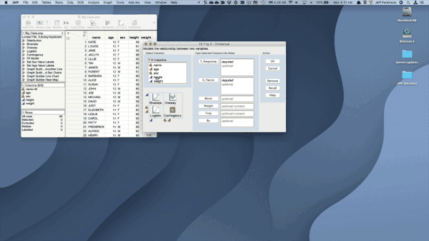

I think there are two shortcuts that will help you significantly with this.
The Ctrl/Cmd key will broadcast options from the red triangle menus across a report. So, you can use Fit Y by X with your four responses in the Y, time in X and By your three other columns (production type, temperature, production site).
Then hold down the Ctrl (Windows) or Cmd (Mac) key as you choose Fit Line on any one of the resulting analysis and you'll add the Fit Line across all of them.
Here's an example with Big Class:
Additionally, for any table in a report window you can right click and choose Make into Data Table to create a data table out of the report table, or Make Combined Data Table to make a data table from all similar tables in the window.
Let us know if you need further help.
-Jeff
-Jeff

Thanks a lot!
Doing it one by one felt like I was doing it wrong, and I was right!
Using ctrl whilst doing the line fit and adding the upper and lower limits to the table significantly sped things up!
