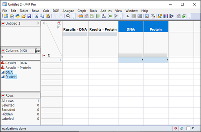

Hello,
I have an import script which I use to import results into JMP from excel. The template excel is used by lots of people and is locked for editing. We have two results columns in the excel which are both called "Results - XXX" where XXX is replaced using an excel marco to what is being studied so changes in each file. We also have columns called JMP Result 1 and JMP Result 2 which are equal to the results columns and in number format. which we use as JMP import can't import a scientific number from excel. When I open the excel in JMP I get something like the image below:
I'm trying to write a script which will extract the word following "Results -" from the column heading and replace the JMP Result Column heading but making sure it replaces the correct heading. so the result would be:
Not sure if this is possible in JMP but any help would be greatly apricated. Not even sure how to start by extracting the end of the string of the column heading let alone the later steps. Thanks in advance.

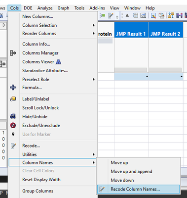

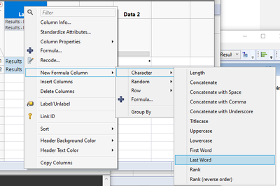

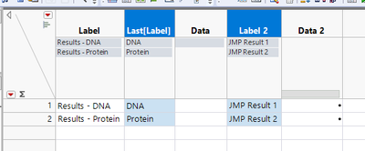

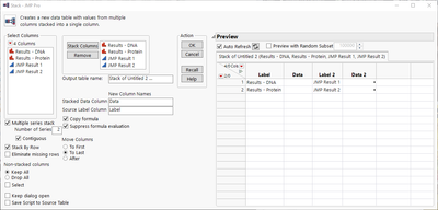

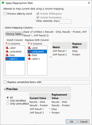

Also non-scripting option came to my mind.
Create stacked table
Create last word column from Label
Now you have mapping table
Go back to your original table and Recode column names
Use Apply Mapping for Table...
And click Recode
Too bad JMP isn't able to create proper script for this automatically as it will just use the mapping values directly in the script so this might be manual process unless you are able to create "full mapping table" somehow to get that filled in to the script
