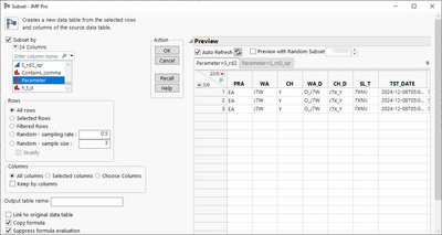

PioJesudoss
Level II
Re: In a data frame Filter column based on another column that contains the column name
Hi Jthi,
Thanks for your reply but what I want is this. I mean, If Parameter has S_rd2_iqr, then I want only the column S_rd2_iqr to be filtered as shown in the screen shot. If Parameter has S_rd2, then I want only the column S_rd2 to be filtered as shown in the screen shot. These parameters will vary each time so I want them to be parameterized
