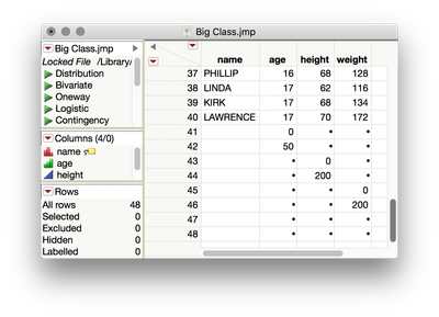

I see just what you mean!  There are a few ways to go about this. Using rows with value ranges staggered by column you can achieve the same result, regardless of what variable is the X or Y:Screen Shot 2018-02-13 at 12.43.55 PM.pngScreen Shot 2018-02-13 at 12.43.55 PM.pngI agree that's not ideal, and in Fit Y by X in JMP 14 the line will extend by default. Another option: Graph Builder has a nice functionality for that sort of plotting using the Formula element, which might be useful to you in general. Write your own formula in a formula column, or for any model save your prediction formula for the mean, as well as the formula columns for the confidence intervals (if you want, but make sure to save the formula columns, not just the values), then pull up graph builder, use the same X as the X variable, then all your formula columns for the Y variable, and then click the Formula graph element. You can then change line colors and styles if you like.
I hope this helps some!
