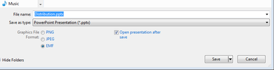

For a Windows interface it's a bit different from the analysis platform report window select...File -> Save As, then in the Save as type window:, select PowerPoint Presentation (*.pptx). I recommend the Graphics File Format: selection is EMF. This provides high quality graphic images AND the ability to fully edit in PowerPoint, text in JMP/JMP Pro report tabular elements.
