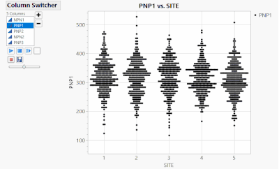

Export Multiple Graphs from Graph Builder with Column Switcher to a Single MS Word File
I have a Graph Builder set up w/ Column Switcher w/ 75 columns.  I want to export all 75 graphs to MS Word as one file.  When I export, I only get one graph (the currently selected column) at a time.  Is there a way to export all 75 at once?

If you want to do this using Column Switcher I think only options are to either manually change the column and then save those (or copypaste) or script it. If you could stack the data, you can use the label as page and then save the report which might work.

You could use the Animation feature at the bottom of the Column switcher - click on record, cycle once through all entries and then import the generated animated GIF into word.

Alternatively, you could add a button to the Column Switcher Menu which triggers Jmp to cycle through the entries and export the graphs as pictures:
Here is an example which animates the Local Data Filter and exports the graphs:
https://community.jmp.com/t5/Discussions/saving-graphs-as-PNG-or-JPEG/m-p/667064/highlight/true#M855...

Thanks Jarmo.  I ended up stacking the columns and using the page grouping to get a graph for each previous column.  They then all exported to MS Word in one multi-page file.
