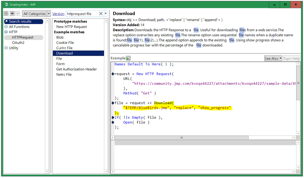

Curl's -H specifies a header, which requires you to use New HTTP Request. open() can add a query string but can't add headers, so it won't do what you need.
help->scripting indexhelp->scripting index
I think you'll need
headers({"X-JFrog-Art-Api:ABcdEF"})
but not the query string and fields.
Once you get the zip file, you can use JMP's zip archive support to get the unzipped members.
You might use download rather than send:
download a filedownload a file
