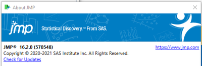

Currently using JMP 16.2.0, in Windows 10.

(Incidentally, are you sure you're not using JMP 15.x not 16.x? Because I could have sworn the we made that change for JMP 16, which would mean the error message you're seeing shouldn't actually exist there)

This is definitely JMP 16, not 15. IT should be installing v17 later today, I will let you know if that fixes the issues.
Re: Error when Saving Project File
I checked the old source, and yeah, you could totally get that error in JMP 16. I'm the one who wrote that feature (and the removed it), so you'd think I'd remember, but it's been a while. (In retrospect, you were clearly using JMP >= 16, because $PROJECT (and the whole concept of saving a file to the project didn't exist in until then). But it's definitely gone in 17, so I'm still optimistic that that will fix your issue.
