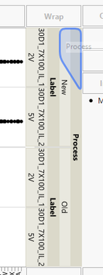

Re: Can I get elements in "Group Y" to "Y" in Graph Builder?
Drop the process to this location
-Jarmo

jthi
You can hide the group title
Might be a good idea to remove min/max from your graph builder script to allow Y-axis to scale as it wants to
-Jarmo

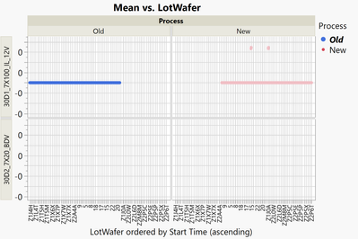

hogi
Level XIII
Nice idea, use a Data Filter as a Column Switcher with modeling Type Multiple Response :)
To move the Y Group labels to the left right click on the Y Group and select Y Group Edge/Left:
To order the entries by Process, the order column has to be numeric.
OK to put the Process label on top?
Alternatively, you could use different colors to distinguish between old and new value.
:Process << Set Property( "Value Order", {Custom Order( {"Old", "New"} )} );
New Column( "Process2", Set Each Value(If(:Process=="Old",1,2)) );
Graph Builder(
	Show Y Axis Title( 0 ),
	Y Group Edge( "Left" ),
	Variables(
		X( :LotWafer, Order By( :Start Time, Ascending, Order Statistic( "Mean" ) ) ),
		Y( :Mean ),
		Group X( :Process ),
		Group Y(
			:Label,
			Order By( :Process 2, Ascending, Order Statistic( "Mean" ) ),
			Show Title( 0 )
		Overlay( :Process )
	Elements( Points( X, Y, Legend( 23 ) ) ),
	Local Data Filter(
		Conditional,
		Add Filter(
			columns( :Label ),
			Where( :Label == {"30D1_7X100_IL_12V", "30D2_7X20_BDV"}  ),
			Display( :Label, N Items( 15 ), Find( Set Text( "" ) ) )
hogi

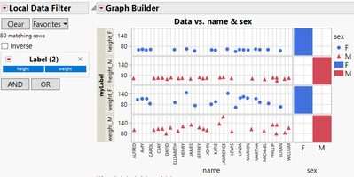

Level XIII
alternative approach, with std. BigClass  (with sex = Process):
Create an new Label with "_process" appended
perhaps an additional subplot as an indicator for the "process"
Names Default to Here(1);
gb = dt << Graph Builder(
	Size( 437, 413 ),
	Graph Spacing( 4 ),
	Variables( X( :height ), Y( :weight ), Overlay( :sex ) ),
	Elements( Points( X, Y, Legend( 1 ) ), Smoother( X, Y, Legend( 2 ) ) )
dtStacked =  dt << Stack(
	columns( :height, :weight ),
	Source Label Column( "Label" ),
	Stacked Data Column( "Data" ),
	Output Table( "Untitled 3.jmp" )
dtStacked << New Column( "myLabel",Character,Formula( :Label || "_" || :sex ));
dtStacked << Graph Builder(
	Size( 494, 335 ),
	Show Control Panel( 0 ),
	Set α Level( 0.01 ),
	Summary Statistic( "Median" ),
	Graph Spacing( 4 ),
	Variables(
		X( :name ),
		X( :sex ),
		Y( :Data ),
		Group Y( :myLabel ),
		Overlay( :sex ),
		Color( :sex )
	Relative Sizes( "X", [240 56] ),
	Elements( Position( 1, 1 ), Points( X, Y, Legend( 37 ) ) ),
	Elements( Position( 2, 1 ), Heatmap( X, Legend( 31 ) ) ),
	Local Data Filter( Add Filter( columns( :Label ), Where( :Label == "weight" ) ) )
