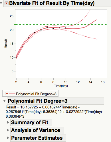

This picture tells a story:
As you know, when building empirical models, extrapolation is always dangerous. To really answer your question, you need more data.

Unless I'm mistaken, it's a predicted value of 22 that is of interest (hence my dotted green line).
