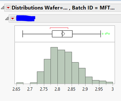

Hello,
I would like to edit the title of my distribution graphs to be a bit more descriptive and easier to match up with another graph I created. I would like the title of each graph to be "Wafer = XYZ..., BatchID = ABC..."
The code I created below lets me edit the title, however, it unsurprisingly lists all the batchids that were listed in the associative array I made prior. (this array just lists all the batchIDs in a column of a table I have). What I would like to do is match the Wafer to the BatchID and display it in the title of each graph with a By statement. Is there anyway to do this? Thank you!

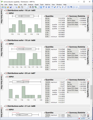

Here is an example based upon your script, but modified to the sample data
Names Default To Here( 1 );
dt = Current Data Table();
batchids = Associative Array( dt:lot_id );
Dis = dt << Distribution(
	Stack( 1 ),
	Automatic Recalc( 1 ),
	Continuous Distribution(
		Column( :npn1 ),
		Horizontal Layout( 1 ),
		Vertical( 0 )
	Local Data Filter(
		Close Outline( 1 ),
		Add Filter( columns( :site ), Where( :site == 1 ) )
	By( :Wafer )
For( i = 1, i <= N Items( Dis ), i++,
	Report( dis[i] )[Outline Box( 1 )] <<
	Set title(
		Report( dis[i] )[Outline Box( 1 )] << get title || " Lots="
		 || Char( batchids << get keys )
Note: I manually closed the Process Capability sections of the output for a better picture
Jim
