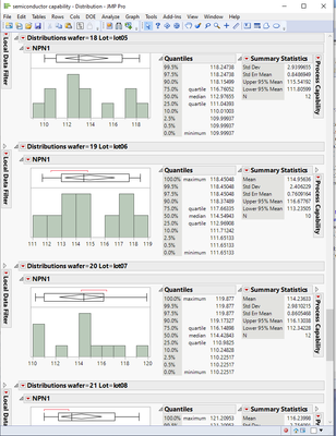

I would take the resetting of the title outside of the initial code to generate the distributions, and change the titles after the distribution report is generated
Here is an example based upon your script, but modified to the sample data
Names Default To Here( 1 );
dt = Current Data Table();
batchids = Associative Array( dt:lot_id );
Dis = dt << Distribution(
Stack( 1 ),
Automatic Recalc( 1 ),
Continuous Distribution(
Column( :npn1 ),
Horizontal Layout( 1 ),
Vertical( 0 )
Local Data Filter(
Close Outline( 1 ),
Add Filter( columns( :site ), Where( :site == 1 ) )
By( :Wafer )
For( i = 1, i <= N Items( Dis ), i++,
Report( dis[i] )[Outline Box( 1 )] <<
Set title(
Report( dis[i] )[Outline Box( 1 )] << get title || " Lots="
|| Char( batchids << get keys )
Note: I manually closed the Process Capability sections of the output for a better picture
