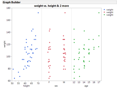

I was wondering if there is an easy way to generate a scatterplot matrix in the graph builder. I would like to create something like this:

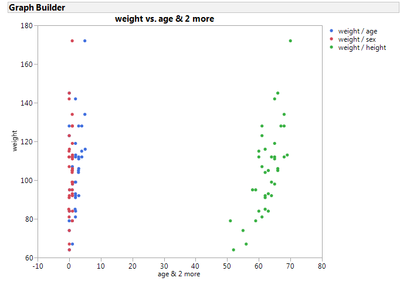

My problem is, that I need to pull over each variable on the x-axis one at a time. If I select multiple variables the GraphBuilder will generate the - for my purposes no so useful - overlayplot:
I'm using this kind of graph often when it comes to the analysis of DoEs and I have 8+ variables on the x-Axis. Then it takes so much time to pull over each variable one at a time.

The 2 methods that I can think of would be to Tables==>Stack the columns you want on your X axis, and then use the "Label" column from the stack as an X Grouping variable. Or, a very simple script, which could be turned into an addin could be written that would take the X columns you specify and generate the Graph Builder code to generate the graph you want.
