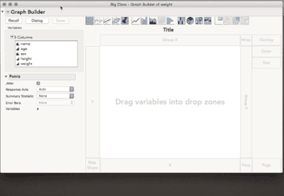

The easiest way to do this is by using the Dialog feature of graph builder with a graph matrix
  1. Launch Graph Builder
  2. Click "Dialog"
  3. Cast variables into roles
  4. Check box for "Graph Matrix"
  5. Click ok
Here's a short video showing that:
I hope this helps!
julian
  2. Click "Dialog"
  5. Click ok
I hope this helps!
julian

shoffmeister
Level V
Re: Easy way to generate a scatterplot matrix using the GraphBuilder?
Thanks so much! That is exactly what I was looking for.
I never had a look at that dialog button before. :-)

julian
Hi Kelly,
The dialog box option for Graph Builder was added in JMP 12 so I'm sorry to say in JMP 11 and earlier there isn't a direct way to do this. Stacking or a custom script would be the next best thing if you want to stay in Graph Builder. Graph > Scatterplot Matrix is also an option and will work well with all continuous Xs.
Julian
