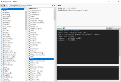

You can send << Min / << Max to axisbox to change it's min / max values.

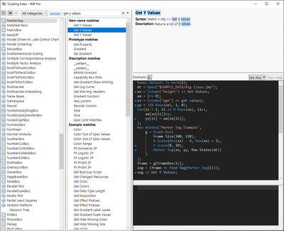

To get the min/max value of column for example by using Col Min/Col Max functions. Optionally you can try to access the marker segment and extract the values from utilizing  << Get Y Values
