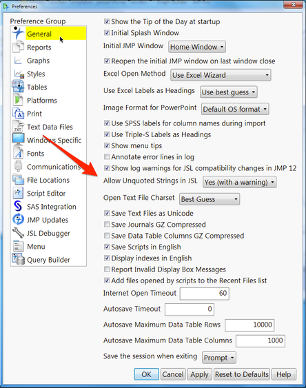

With some assistance from @XanGregg I was able to figure out that it's a bug related to the Allow Unquoted Strings in JSL preference.
To avoid the message, set that preference to "Yes (no warning)".
We'll see if we can address this in a future maintenance release.
