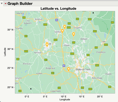

@Mark_Bailey is quite right. But you 'can' add any image as a watermark to a graph. This may or may not be what you are after, and if you do this you have the responsibility to take care of the correct registration of the map with the axes. I didn't do this in the example below.

I just want JMP to get their act together and make it possible for users to select their geolocated images on the background map.
