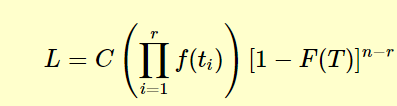

For censored data, the likelihood function is:
So isn't the constant set beforehand, and not a function of data? Thanks!
Ref: https://www.itl.nist.gov/div898/handbook/apr/section4/apr412.htm

C can be different things for different distributions, depending on what is f.
For example, when fitting a Weibull likelihood, if f and F are density and distribution functions of Weibull, then there is not separable constant at all.
However, the likelihood is equivalent to a form, in which there is a constant C, and f and F are density and distribution functions of Smallest Extreme Value (SEV) distribution. I guess that is what the NIST formula is depicting.

Since JMP is giving the loglikelihood value, then when taking the log form of the formula, doesn't the C constant become separate? That's why I'm confused, because I thought that the constant could be set this way.

In this context, the constant C is not a known quantity before seeing the data. In general, when one says the loglikelihood does not include a constant, that usually means that MLE is not affected by subtracting the constant from the loglikelihood. The constant can be anything that does not involve parameters. E.g. constant can be a function of data, a function of sample size, etc.
