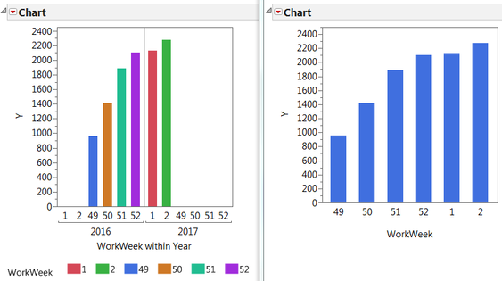

I have data by week number from Oct 2016 to the current week.  I want to show the week numbers in correct order on the X-axis on bar chart going from week 48, 49, 50, 51, 1,2,3 etc. Or value ordering for WeekNumber column in the order of time stamp can help.
I created Year as another column and used Year axis along with WeekNum on Bar chart. But it didn't work as expected. please see the attached charts. Left one is the one I am getting right now, and the right one is the desired one. For a small dataset, we can reorder the WW values but it's tedious for a large data set.

Thanks Jim. Yes, WW and Year are in numeric. but it didnt work out with ordinal modeling types for these columns.
Please see the attached chart. Desired chart is in the right and the one i am getting is in the left. Notice the week numbers. I had to reorder the week numbers to 49, 50, 51, 52, 1, 2.. which is quite tedious with large data set. Also i want to put it in script.

If you use Chart Builder, setting Year and Work Week to Ordinal and dragging both of them at the same time to the X axis and then drag the Y variable to the Y axis you will get the below chart

Thanks so much for the help Jim. It worked.
Now i have to add this capability into my script. Was looking on web but didnt find any solution. Please let me know if you can suggest something.
