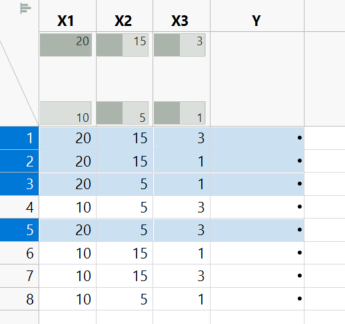

I constructed a DoE screening design 2^3 and entered the actual value ranges for each factor. Now, of course, the resulting data table with the design contains the actual factor values and not the coded ones (which would range from -1 to 1).
Is there a possibility to transform the actual factor levels from this data table directly into their coded ones in a direct way, e.g. by just clicking on the right button in JMP? I know how to do this by applying the appropriate transformation formula on each column. But here, I am interested by an easy JMP operation. E.g. in Design Expert, you just need to click on the menu to switch between actual and coded coordinates (or vice-versa).

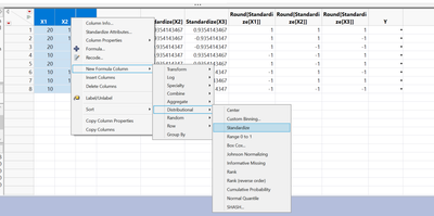

Hi Christian ( @Christian_P  ),
I am curious as to why you want to do this. Is it to explore the "pattern" of the design? There are other graphical ways that you could do that: the interactive distribution plots in the column headers might help.
I don't think there is any one-click way to do this.
Probably the fewest-clicks way is to select all your factor columns then right-click on one of the column headers > New Formula Column > Distributional > Standardize.
Then do the same for these new columns but choose Transform > Round... > OK (defaults should be fine)
I hope this helps,
Phil
