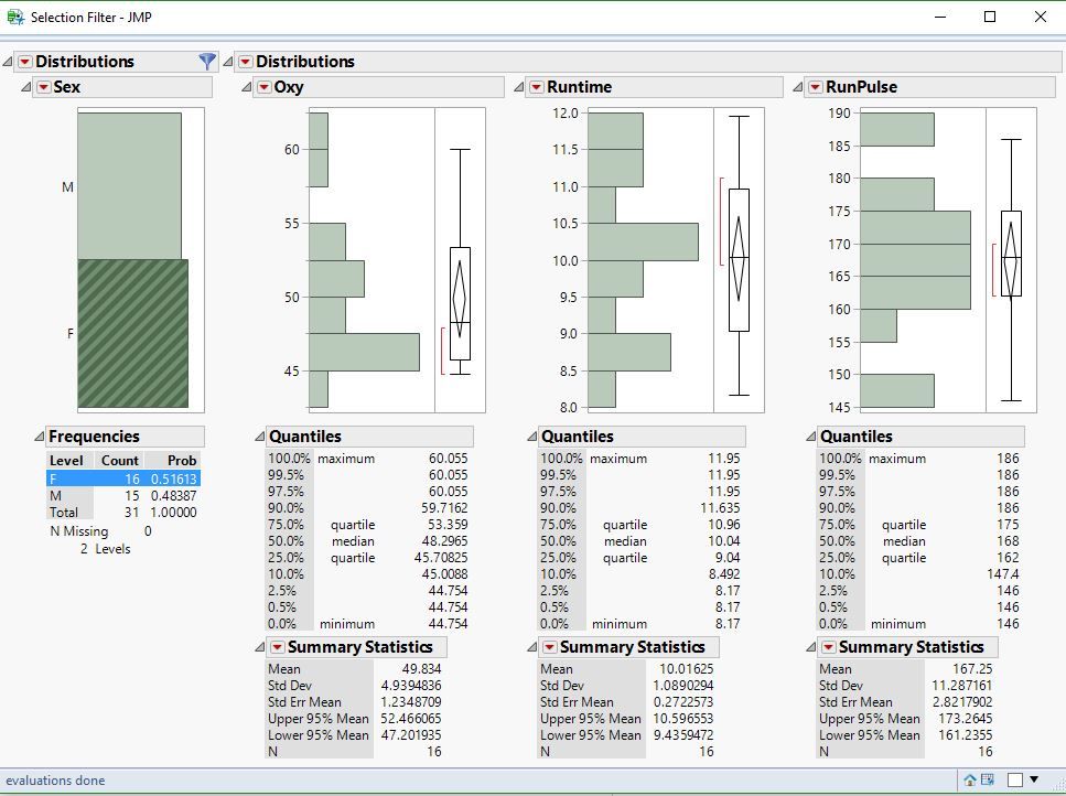

I would like to calculate the data in the distribution-overview based on the selection:
Here for example I would like to see the summary statistics direct after selecting this data (new table calculation). For now I just can see this specific calculation if I Hide and Exclude the unneccesary data in the raw-data-table.
Is this possible?
Im looking forward to your answer. Thanks alot!
Fabian

txnelson
Re: Distribution analysis (e.g. summarize statistics) direct calculation after selection?

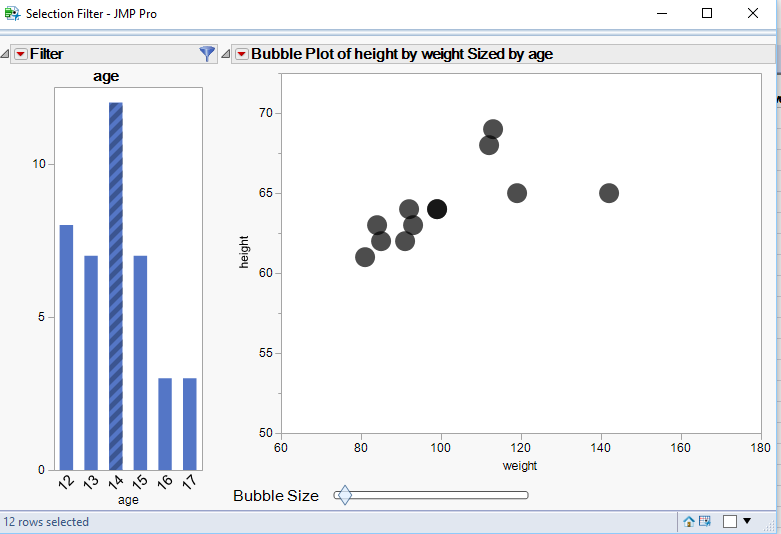

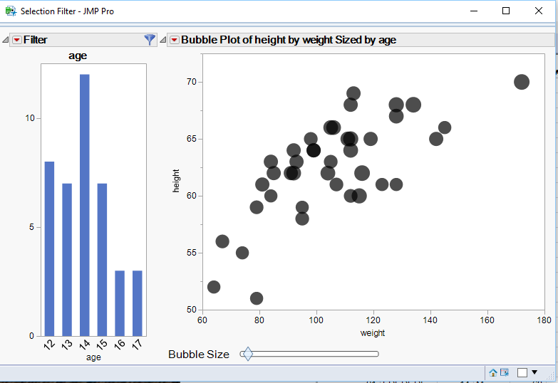

Or are you looking to click on the Male/Female distribution, and for it to change the values in the other graphs
Here is an example from the Scripting Index using a Data Filter Source Box
Names Default To Here( 1 );
New Window( "Selection Filter",
	Data Filter Context Box(
		H List Box(
			Data Filter Source Box(
				Graph Builder(
					Size( 208, 207 ),
					Show Control Panel( 0 ),
					Show Legend( 0 ),
					Variables( X( :age ) ),
					Elements( Bar( X, Legend( 3 ) ) ),
					SendToReport(
						Dispatch(
							"Graph Builder",
							OutlineBox,
							{Set Title( "Filter" )}
			Platform(
				Current Data Table(),
				Bubble Plot(
					X( :weight ),
					Y( :height ),
					Sizes( :age ),
					Title Position( 0, 0 )

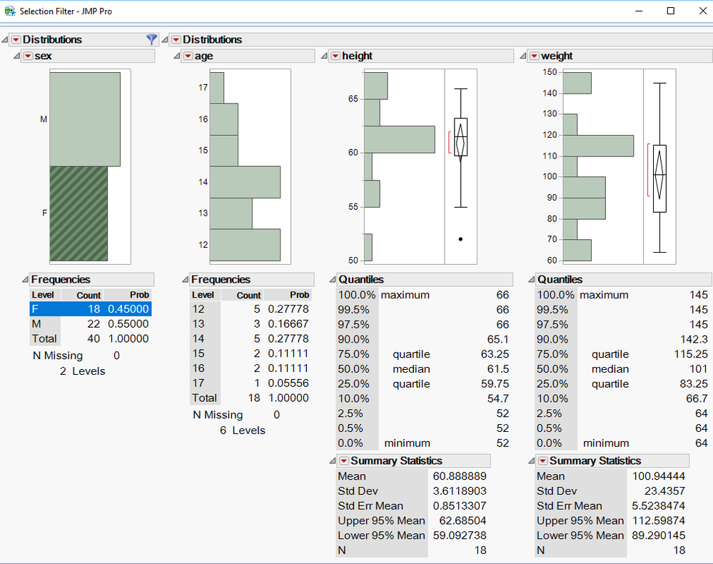

Here is the code adapted to the example you gave
		H List Box(
			Data Filter Source Box( Distribution( Nominal Distribution( Column( :sex ) ) ) ),
			Platform(
				Distribution(
					Nominal Distribution( Column( :age ) ),
					Continuous Distribution( Column( :height ) ),
					Continuous Distribution( Column( :weight ) )

Fabian88
Level I
@ian_jmp - thx. the local data filter is a good way to select the data!
@txnelson - I like your solution over the Data Filter Source Box as well.. i rebuild your solution by using your script! But can you show me the solution how i can set up this directly over the jmp software? This would be handy to show this to my College.

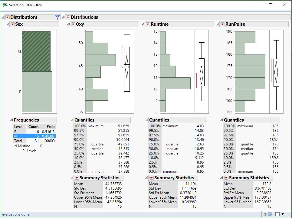

Fabian88
Level I
Sry..
If i run your script based on my data,  I get the "Data Filter Context Box". If i select M I get the new graphs and as well the new calculated "Summary statistics".
Thats excatly how i want it.
My last question here is: How can i set up this without using the script? Is there a solution which i can select in the jmp-software? I want to explain my collegue to set this up without using the script (we don´t have programming skills ;-))
Do you understand what I want?
txnelson
The Dashboard facility in JMP has a template that would allow you to setup such filtering..
     New==>Dashboard==>Hierarchical Filter
Jim
