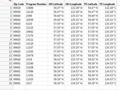

Now, the issue is that I would like to script to calculate the distance between each pair of Lat. and Long.
For example:
In the table below, I have computed the distance and time between row 1 pairs of Lat. & Long. Which is perfect!! that will do for all 20 rows giving 20 unique distances between household location to the destination of the program.
So, in row 1 the program # 15896 with PS Lat. 56.47 N & PS Long. 132.38 S is certain distance away from the Household whose HH Lat. & HH Long.
Since we want to know the distance of each household from each program #, how can I calculate, such that, JMP captures the distance between each household Lat and Long acrosss each Program Lat and Long and not just the first program? In this table, I have 20 rows, using what I have described we should have 400 difference distance calculation instead of just 20. Do you know a way to go around this?
My original HH Data Table has 156,737 Unique households records with their respective HH Lat. & HH Long. The Household file has 15,655 unique HH Lat. & HH Long.
The Program Data Table with 2,747 Unique Program #s with 329 unique PS Lat. & PS Long. I want to calculate the distance from each unique household Lat. & Long to each unique Program Lat. & Long., such that, the distance is calculated across each program. That will be 15,655 *329 and the resulting table or the total distance should be about 5,150,495 records.
Jenkins Macedo

Re: Distance Calculation using Latitude and Longitude
Hi ron_horne and I hope you are doing well. I know this has taken some time since we last chatted on this thread. The project was put on hold and it is now up and running and in about few weeks, the resulting table will be deployed in production by our campaign team.
I did apply the script and it worked perfectly as expected!! Great job!!
As you know the script calculates the distance between pairs of (HH Lat. and HH Long.) to (PS Lat and PS Long.), which is what was originally what the project was designed to capture. I have used the resulting distance to calculate the time that it will take for each household to attend one of our program that is 1, 3, or 5 hours away from their homes.
For example:
Jenkins Macedo
