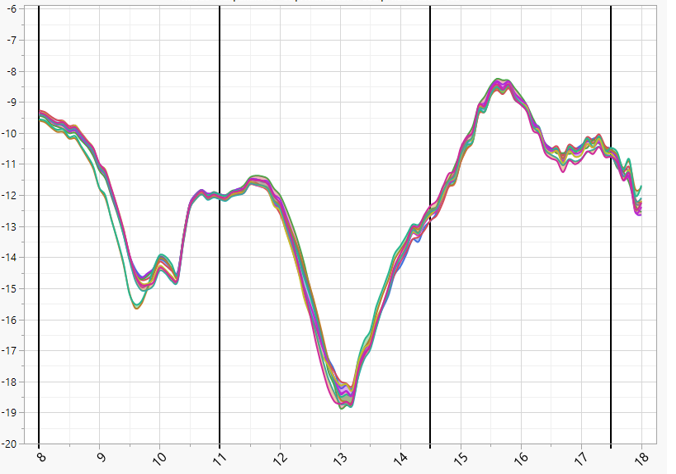

I am looking for some help in extracting data values at a specific point on a -x-y plot and putting them into a table to add to a presentation. I have attached a picture of a plot and if you notice there are 4 Ref Lines ( 8, 11, 14.5, and 17.5). I would like to get get the exact value for each device at that specific point and put them into a table. I have tried Summary & Tabulate but I can't seem to figure this one. This will go inside a script that loops through each test condition (96) and plots the data.

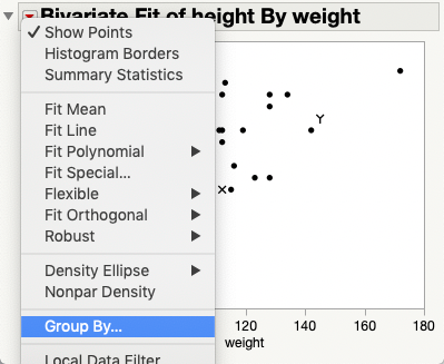

Under the red triangle menu choose Group by...

I can't tell for sure, but it looks like you are displaying fitted splines in Graph Builder.
If that's the case your best bet is to use Fit Y by X to fit the splines and then save the prediction formula. You can then use that formula to get predicted values for each of your reference line values.

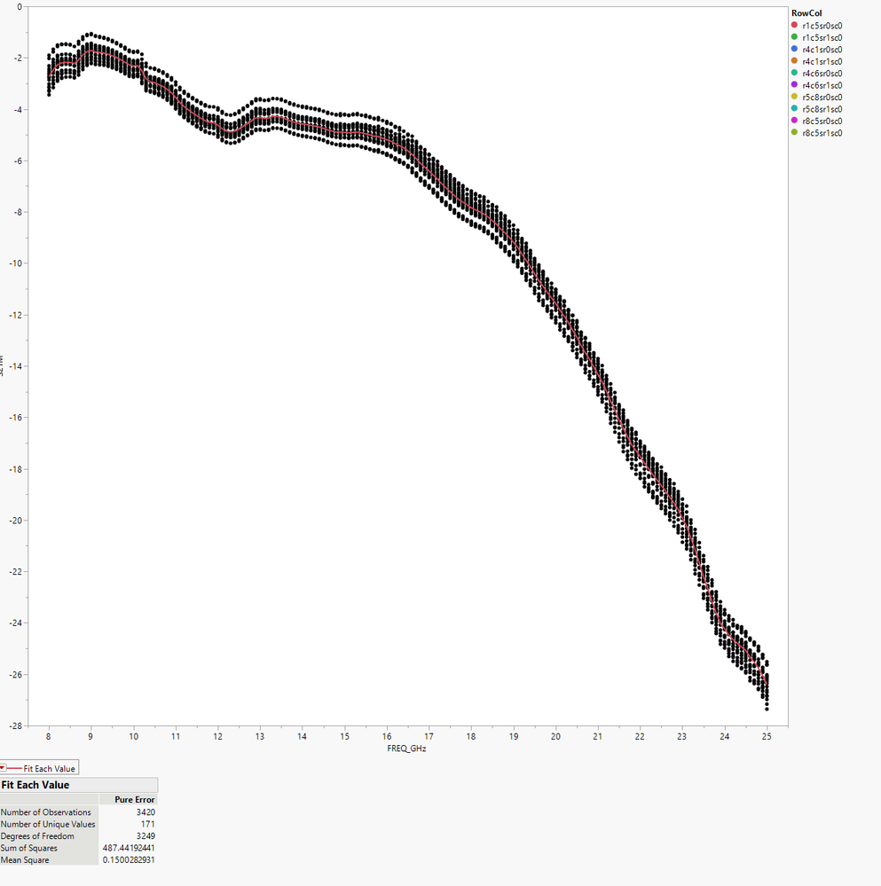

I see what you mean, thanks. Question? I don't want to plot any mean values which anything with "Fit" will do apparently, I want to connect the points for each of the 10 devices of actually how it looks with the points only. How does one accomplish that?Capture.PNGCapture.PNG
Re: Displaying data values from Graph Builder
There are many ways to connect the data points with a line. One way is in Fit Y by X, from the red popup choose Flexible > Fit Each Value.

Thanks for the reply.. I tried that and here is  what i get....  Ideally, i would like to get rid of the points and just use the line without having to plot means... The 1st picture is exactly how i would like it to look without it again, using means.. Capture.PNGCapture.PNG
