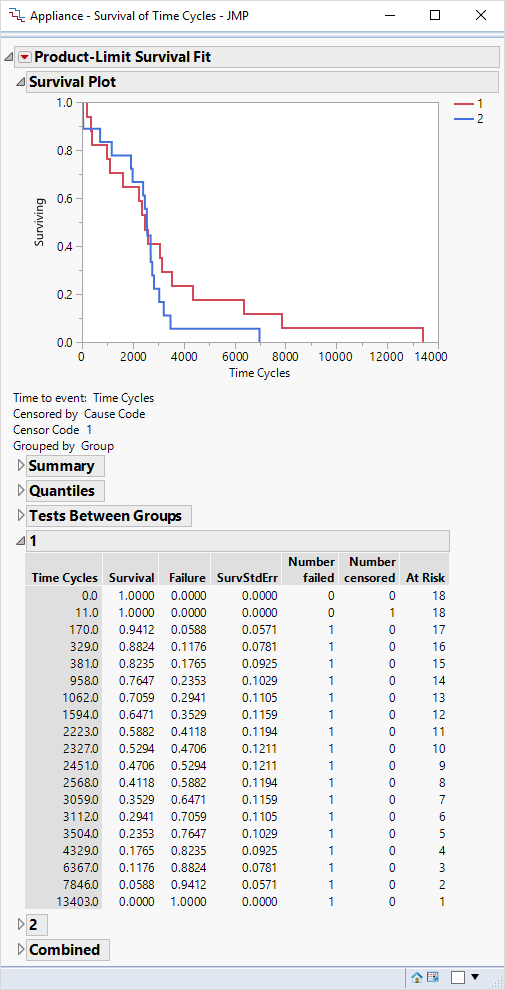

Try Analyze > Reliability and SurvivalSurvival with the life time data column in the Y, Time to Event role, the censoring indication data column (if there is one) in the Censor role, and the group membership data column in the Grouping role. Here is an example:
Click OK and you will see the desired plot at the top of the window:
I do not understand the 'at risk table' that you show. I do not think that JMP provides this table directly but it can probably be obtained with a summary action on the estimates.
You can obtain the estimates by opening the outline at the bottom of the window for any group or the combined observations. For example, here is Group=1 estimates:
The original suggestion of using the Life Distribution platform with the Compare Groups tab might also work.
