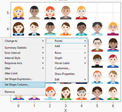

To use the images as shapes for the data points, you can also specify the column via Set Shape Column in the GraphBuilder command.
Or later, by right-clicking into the GraphBuilder window and slecting  Set Shape Column ... from there.
This allows to use different columns for different plots - and have some plots with standard markers.

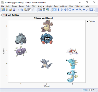

jthi
Re: Display PNG image from URL into a Wafer Map
Leave Filename column as Character. I would also suggest using full paths of the images as it makes it easier to load the images (if you cannot do that, it might be easiest to use Get Default Directory() or Convert File Path() to build those for image loading column). Also using images as markers will make them (most likely) dependent on the graph size and used marker size. If all images are same size and you don't need graph builder, building custom display can also be an option.

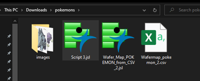

My images, csv and images are in Downloads/pokemons folder
I did some path cleanup in the script for paths
View more...

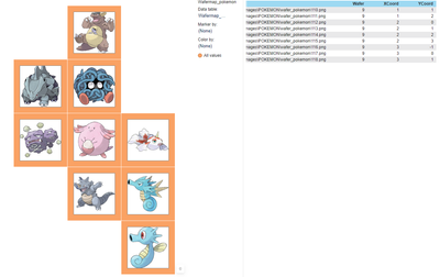

dt << New Column("ImagesWithBorder", Expression, None, << Set Each Value(
	Local({bb, img},
		bb = Border Box(Left(15, Empty()), Right(15, Empty()), Top(15), Bottom(15),
			img = Picture Box(Open(Get Default Directory() ||"images/" || :Filename, png))
		bb << Background Color("Orange");
		img << Background Color("White");
		bb << Get Picture;
gb = dt << Graph Builder(
	Size(457, 714),
	Show Control Panel(0),
	Variables(X(:XCoord), Y(:YCoord)),
	Elements(Points(X, Y, Legend(3), Set Shape Column(:ImagesWithBorder))),
	SendToReport(Dispatch({}, "Graph Builder", FrameBox, {Marker Size(30), Marker Drawing Mode("Normal")}))

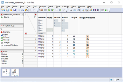

Data table:
Without borders and marker size as 15

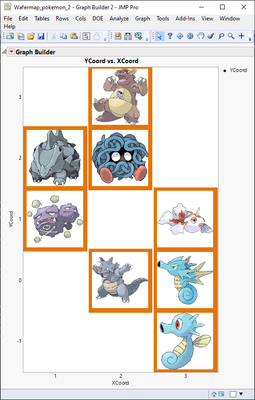

Borders and marker size 30:
If I modify graph size the marker size won't keep up:
