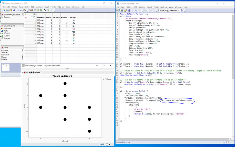

hi Jthi, thanks for your help.
But I obtain circles instead pokemon images .... a graph parameter to change ?
jthi
Re: Display PNG image from URL into a Wafer Map
Graph builder might be plotted from wrong data table. Based on window names: graph builder is using table Wafermap_pokemon_2 and data table is which is visible is Wafermap_pokemon_2 2). Maybe Wafermap_pokemon_2 data table doesn't have Image column properly set?
Hi Jthi,
thanks again.
Sorry, I have always point or circle instead of pokemon images.
I suspect  the command "Set Shape Column(:Images))" is not functional on my side ?  (in V15.0.0 or V15.2.1)

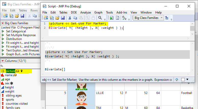

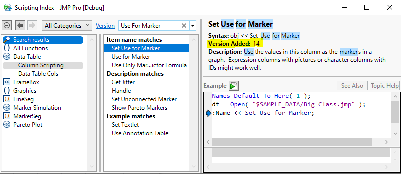

John_Powell_JMP
@jthi  has a good suggestion. Set Use for Marker was implemented in JMP 14 according to the Scripting Index:
When using a function for the first time, it's good to look it up in the Scripting Index under the Help menu.
You may also want to turn on the embedded log in the script editor, (Right-click > Show Embedded Log)  so you can see errors when you run your script.
Hope this helps,
~John

John_Powell_JMP
Hi @BiX ,
The example I showed was for use with the Big Class Families.jmp sample data set. 'height', 'weight,' and 'picture' are columns in that data set, but are not in the table you create in your script.
To use 'Set Use For Marker' in your script, you need to send the 'Set Use For Marker' message to the 'Images' column that you create in your script before the Graph Builder function.
To do this, replace everything starting with 'height = 20;' to the end with the following:
:Images << Set Use For Marker;
