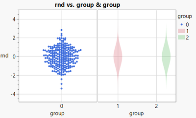

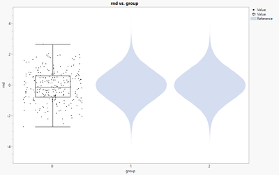

I have some (outlier) data points and want to compare the individual values with 2 reference sets.
ideal: points for the small set and violin for the references.
Can I specify this in Graph Builder?
workaround 1: fill the x axis twice
workaround 2: ... with a second question use points (for everything) - and packed jitter to get a feeling for the distribution. But graph Builder is a little lazy when calculating packed jitter positions for larger data sets.
You could build that in one chart by creating separate x or y columns for each type of graph you want, and then limit which variables are used in each feature.
