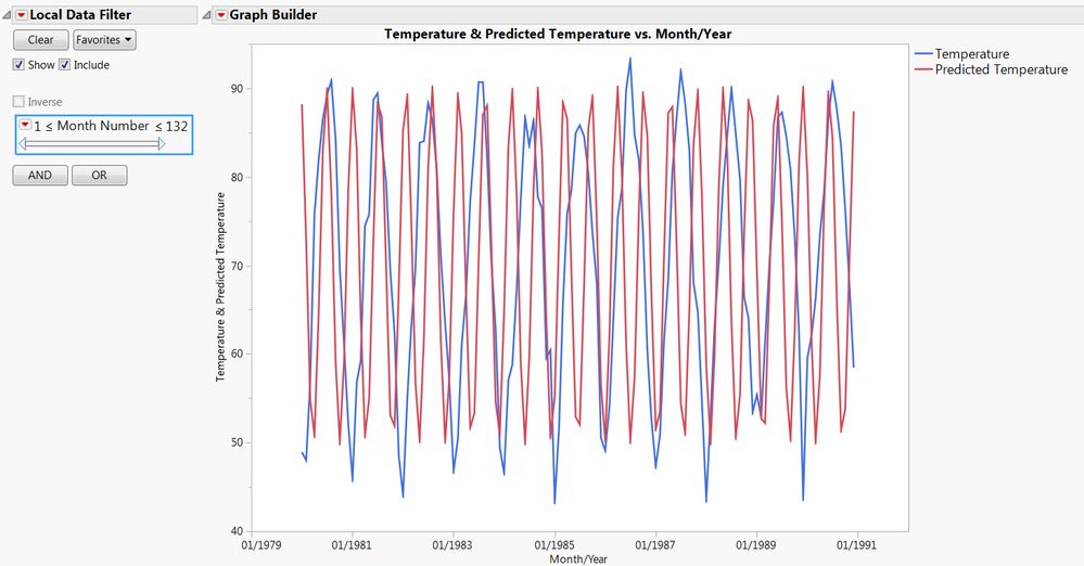

The above code produces this : ( Slider View)

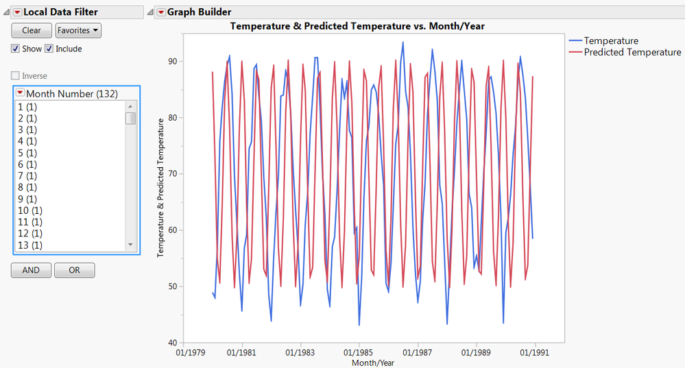

Instead , by remodeling the column as Ordinal data , I can generate the LIst Display for the data filter

The above code generates this :

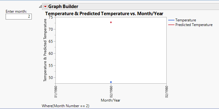

You could set the where clause in the data filter yourself when the value in a number edit box changes, and hide the normal user interface:
Names default to here( 1 );

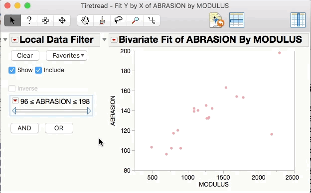

I like to keep things simple. The 'slider view' that you refer to shows the upper and lower limits of the current filter. You don't have to use the slider to change the range. You can also click on the current value (number) and enter a new one. This way you can use the data filter object (simple) and avoid additional coding that might not really add new functionality.
Jeff_Perkinson
Re: Display Data Table Filter As a Simple Text Edit Box ( Not List Not Slider )
Here's a GIF that shows clicking on the value in the slider to set it.
