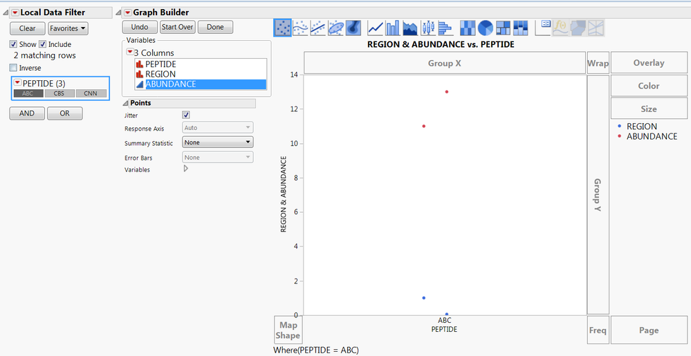

To explain a little further with Jim's solution:

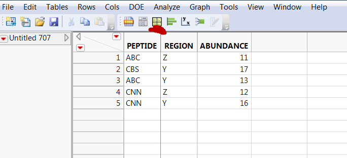

1. With your data table as the current window, click on the data filter icon.
2. Click on Region and then Add
3. If you want to filter by a second column, click And, click on Peptide, then click on Add
You'll get something like the picture below.  I clicked on the Z region, and then Shift-clicked on ABC

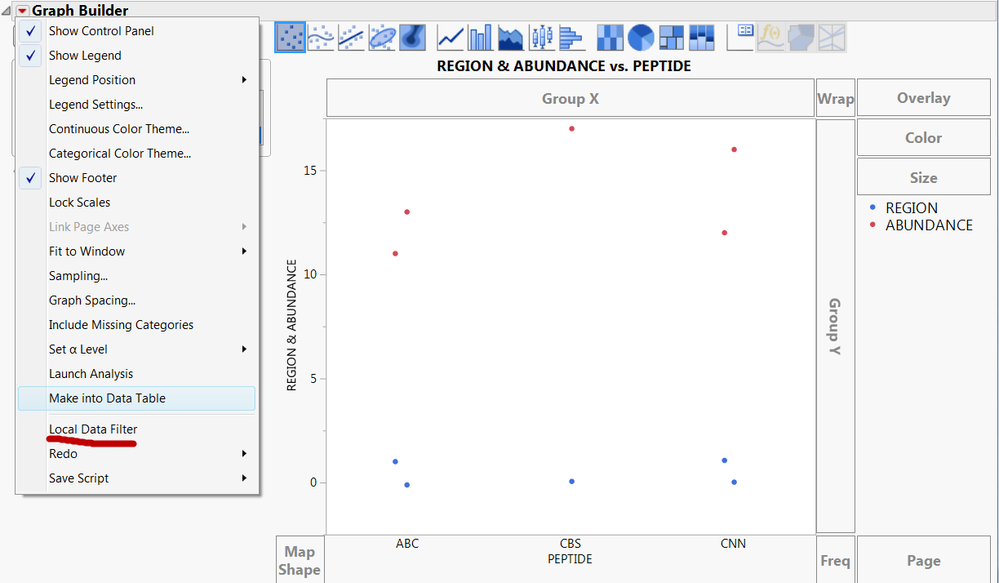

Once , you open the Graph builder, use the local Data Filter that is provided as highlighted below .
Now , what you want to do is , select columns on the basis of which you want to filter under Data Filter and you can achieve what you are after .
The same can also be achieved through the Tabulate platform where the result is a table and not a graph .
