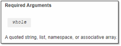

According to Jmp manual, the first argument of contains has to be
Good news: contains also support matrices as first argument  :)
But it doesn't seem to be comfortable with an expression like
:col1 << Get Values
